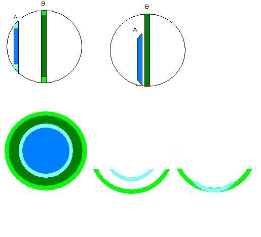

Here's an illustration to support Hesh's arguments if i may be so bold. As always is the case, exaggeration is the best teacher.
The image i (hopefully) included has 5 pictures 1-5 from top left to bottom right.
Image 1...
Shows a ~2 inch sphere. If you cut the sphere in half, you have a bowl which is analogous to the radius dish.
There are two slices which equate two two braces positioned differently in the dish. The lighter colors next to the dish represent the actual brace portion of the slice.
Image 2.
if you take slice A and move it to another portion of the disk, say next to slice B, you can see how the bottom of the brace is angled differently, and if i could rotate the slice in paintbrush, you'd see that brace A glued at position B would result in the brace being tilted. Does it matter on a 25 foot radius? For you to decide.
Image 3..
imagine rotating image 1 so that slice A is between you and slice B.
Image 4...
Cut the sphere down to represent the dish and save only the outer edge of the slices to represent the braces.
Image 5...
Slide brace A to where brace B is and you can see that not only is the angle of the bottom of the brace different (from proof 2 - See theorems! visual Math!) but the actual radius is different.
Does it matter? Maybe not.
Is Hesh Correct? Absolutely!

I think that what you have shown is a cylinder, not a sphere, you are missing the third dimension that a shpere has over a cylinder. A radius dish is best imagined by thinking of slicing a section out of a ball (if it would hold it's shape), there is no flat spot anywhere on the object. I agree 1000% with Todd Rose on all that he said and I see it completely in the body of the guitar I have put together. I have made probably 50 radius dishes now and have spent a lot of time thinking this through also. If you sand a brace at any point on the dish it is going to fit in any other place of the dish, as Todd says, move them around and see for yourself! Keeping the braces perpendicular to the plate is a good idea but at the end of the day, you are doing this part by hand and you won't be entirely accurate all of the time, but you should always be so close that you could not tell. Besides, the braces are typically shaped in such a manner that you could never measure it in any regard.

rob, that is not a visual represention of what occurs.

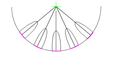

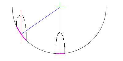

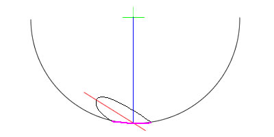

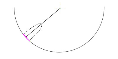

   These are a few figures that give an exagerated conceptual difference to sanding braces at different angles to the center line(green CL) of the sphere. This is to keep the brace CL(red CL) perpendicular to the top and not to the CL of the spherical form.
    The first figure shows, though the spherical radius is the same, the spherical segment(purple) generated on the brace is not, again to keep the CL of the brace pointing "straight up" in relationship to the finished guitar.
   This figure shows that one can, in fact, as Rod said sand in any place in the spherical sanding dish and generate the same form simply by angling(blue line) the brace CL{red} to the spherical CL(green).
   One can do the opposite by sanding offcenter to the perpendicular CL of the spherical radius and still obtain the proper spherical segment formed on the brace.
   By not sanding as Hesh does what one really gets is a toroidal segment(the outside portion of a donut shape) not conical. This causes the braces CL's to be lined up at angles to the horizontal plane of the guitar, the top facing up.
    Yes the spherical radius is the same, the spherical segment, again, is not! Considering the size of the radius in real terms does it make a difference.... depends on how much you want to put into the guitar. I can do the math in numbers but getting into spherical radius points gets hairy if you don't do it often and I'd have to pull out length and width measurements of the braces themselves.

Billy - Very helpful drawings here, but one correction. As also pointed out by Rob in his also very helpful drawing, the radii of the braces done off of the low spot are indeed smaller. Think of a globe with latitude lines above and below the equator. The braces away from the low spot above are being oriented in the direction of constant latitude, and each circle representing a constant latitude gets smaller (i.e., lower radius) as you move away from the equator. So, these braces, which are oriented along latitude rather than great circle lines, do get a tighter radius as indicated in Rob's drawing.
